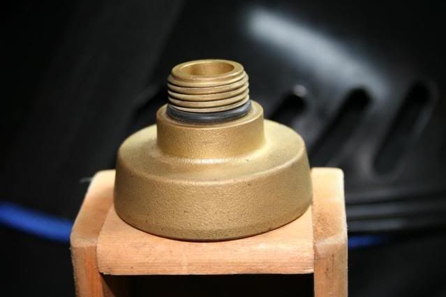

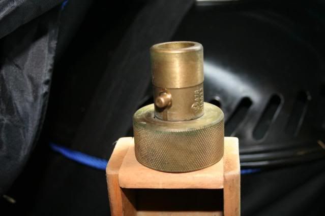

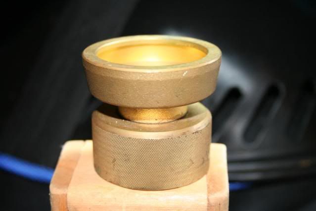

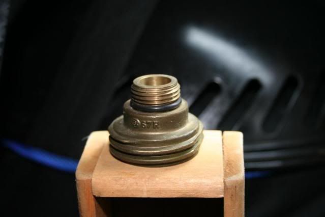

The pictures above, the first is the same as the third one will fit the lpg tanks on the cooking the other one will fit the lpg engine conversion
If you log on to autogas 2000 ltd there shows 8 adaptors i think the new euro quick release is the one to buy.

my inherited selection Bryan....uk is obvious but i'm sure one is spanish/portugese.
useful if anyone can enlighten us both.
French Dish, screws inside your Bayonet.
ACME screws inside your Bayonet.
French Dish converter screws on to the ACME on your domestic tank
English Bayonet converter, screws onto the ACME on your domestic tank
Spain has a mixture of English Bayonet, French Dish and the new Euro adaptor
Portugal is all French Dish
ACME is only found in the low countries I believe.
See under my signature for Autogas map
